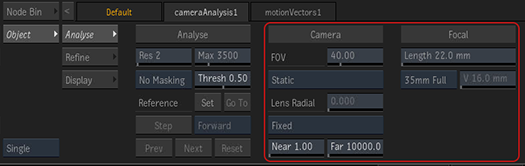

Setting the Field of View
Knowing the field of view (FOV) of the camera used to shoot the media is useful information that helps with the 3D tracking analysis.
If you know the FOV:
  1. Set Compute FOV to Fixed.
  2. Enter the FOV value.
    Having an accurate FOV helps the analysis by providing a reliable data point for the Camera Analysis.
If you do not have the FOV, but know the focal length and the camera sensor format:
  2. Enter the focal length in the Length field.
  3. Select a format from the Camera Sensor Format menu.
    The node calculate the actual FOV from the focal length and the size of the sensor.
    Tip: If you do not have the sensor format but have its dimensions, select User Defined and enter the height of the sensor in millimeters.
If you know neither the FOV nor the focal length and the camera format, you can let the Camera Analysis compute it for you. While more information is always nice, the analysis algorithm is robust enough to compute the FOV itself.
If you do not know the FOV:
  1. Set Compute FOV to Static.
    Camera Analysis computes the FOV for you during the analysis.
If you do not know the FOV information and the shot contains zooming in and out while the camera moves:
  1. Set Compute FOV to Dynamic.

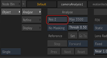

Setting the Resolution of the Analysis
The Resolution of the track refers to the granularity of the track. 1 tracks every frame, 2 tracks every other frame, 3 every 3 frame and so on.
So a higher value skips frames for a less accurate track: the movement of tracking points are interpolated between analysed frames. While skipping frames can create a less reliable track, it's great for quickly testing the camera analysis on a shot.
To set the resolution of the analysis:
  1. Enter the resolution in Resolution.
Tip: You can always try out Camera Analysis with a resolution of 10 to test out the tool. If the tool appears to track well, you can then perform a lengthier analysis with Resolution at 1 for the greatest accuracy.

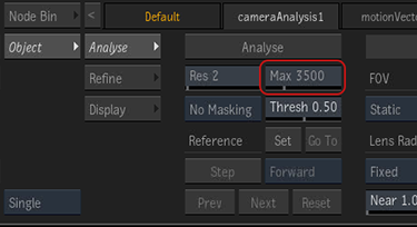

Setting the Number of Trackers
The number of trackers should be proportional to the detail in the image, with more trackers making the analysis longer to complete. The default is 3500 trackers per frame.
This value sets the maximum number of trackers: the Camera Analysis might compute a lower number of trackers.
To set the number of trackers:
  1. Enter the maximum number of trackers in Max. Number of Trackers.

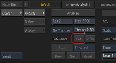

Setting the Reference Frame
The Reference Frame is ideally the frame showing the most detail, without any motion blur or occlusions. Frame 1 is typically good in most cases.
To set the Reference Frame:
  1. With the timebar, scrub to the frame that presents the most details, without motion blur or occlusions.
  2. Click Set.

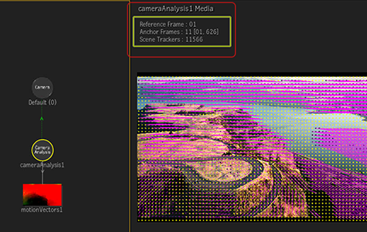

Review the Analysis
Once the analysis is complete, the Camera Analysis node tells you how confident it is about the quality of its analysis.
To the display the analysis quality information box:
  1. Set the Viewports to the 2-Up view (Alt+2).
  2. In the Schematic view, select the Camera Analysis node.
  3. With the cursor in the other viewport, press F8.
  4. The Analysis Information box appears in the top-left of the viewport.
    The Information box appears in all three Camera Analysis F8 views (Camera, Media, and Scene).
2-Up View: Schematic view and Camera Analysis Media view displaying the Information Box—Credit: www.pexels.com | Ruvim Miksanskiy
FeatureDescription
ColourFrom bright green (best) to red (worst), the colour of the box indicates the quality of the analysis. A higher quality analysis means better interpolation between frames, and fewer slipping tracking points.
Reference Frame:The ID of the frame you set as the reference point.
Anchor Frames:The number of anchor frames in the shot, with the first and last frames used as anchor frames in brackets.
Scene Trackers:The total number of points used across the entire shot for the analysis.
Note: Hide or reveal the Camera Analysis Information box with Camera Analysis object menu Display Show Information.

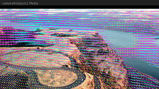

You can also determine the quality of the track by looking at the tracking points.
To see the tracking points:
  4. Press F8 until you see the Media view.
    You can now see in the viewport the frame with its tracking points (yellow dots) and their motion in the frame (magenta and cyan tails).
  5. Scrub the timebar to view how the points track the image. A good track is one where tracking points do not slip as you scrub the shot.

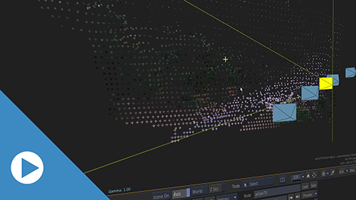

Anchor Frames
An anchor frame is a frame automatically selected by the algorithm to estimate the camera motion and the point cloud. Each anchor frame is selected so there is minimal coverage between each one (each share a minimal number of points with the previous and next anchor frame) and there is a minimal expected parallax changes from one frame to another. This means that while you can ask for an analysis of every 5 frame, if there is very little parallax change and that point coverage is sufficient, you can end up with only a few anchor frames for your shot. But this does not mean that the analysis is bad. It only means that the algorithm required just a few frames to anchor its analysis.
In the Camera Analysis Scene view, you will have as many camera icons as there are anchor frames.

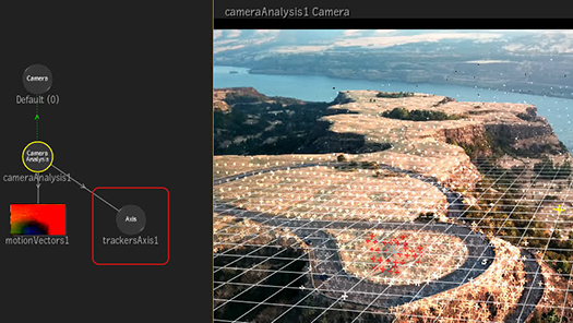

  1. Create an Axis specific to the Camera Analysis node, the trackersAxis.
  2. Add the object to the trackersAxis.
To create the trackersAxis:

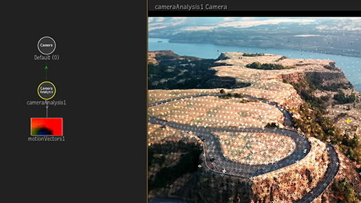

  4. Press F8 until you see the Camera view.
    This displays the point cloud generated by the analysis.

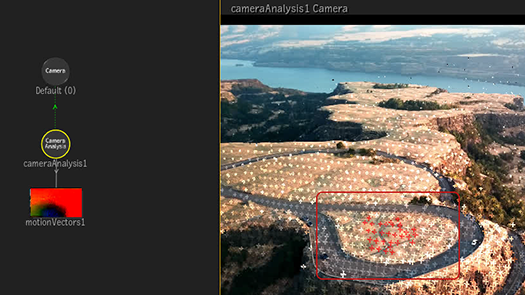

  5. In the Camera Analysis Camera view, select the trackers located where you want to position the object.
    You can select only one tracker, but selecting multiple trackers it that spot gives you an average position that will better match the perspective of the shot. Try selecting points lying in the same plane.
    Tip: Ctrl-drag to draw a selection box.

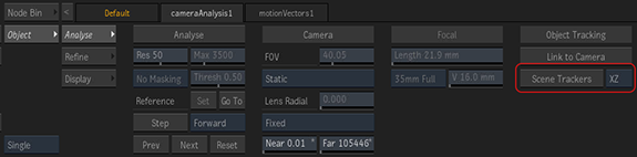

  6. In the Camera Analysis object menu, click Scene Trackers.
    In the Schematic, a new axis, trackersAxis, is created under the Camera Analysis node .
To add the object to the scene:
  1. Display the Result view (F4).
  2. Connect the trackersAxis to the Axis of the object.
    The object snaps to the trackersAxis position. You can now adjust that object position by editing its Axis. And scrubbing the timebar, you can see the object tracks with the rest if the shot.
The trackersAxis plane aligns initially according to the Grid Plane button, with XY (vertical alignment) being the default. To change this default to the horizontal, set Grid Plane to XZ.
Note: Apart from being created with the Scene Trackers button, the trackersAxis is a regular Axis that can be moved, rotated, and scaled.
