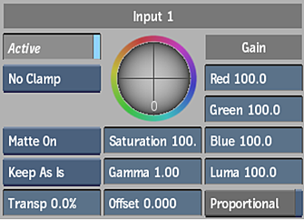

Input Settings
Note: Input 1 and 2 settings are identical. Activate and use based on inputs selected for Blend & Comp.
Active button
Enable to activate the input.
Clamping box
Select a clamping option.
Matte box
Select how the matte is used when blending.
Pre-multiplication box
Select whether the colour values in the input are pre-multiplied or divided from the alpha, or left as-is when blending.
Transparency field
Displays the transparency value.
Gain Trackball
Adjusts the gain of the input.
Saturation field
Displays level of colour purity in the image.
Gamma field
Displays the gamma level.
Offset field
Displays a value that modifies all of the colour parameters.
Red Gain field
Set the percentage of colour values in the red channel.
Green Gain field
Set the percentage of colour values in the green channel.
Blue Gain field
Set the percentage of colour values in the blue channel.
Luma Gain field
Set the percentage of luma gain value to display.
Proportional button
Enable to adjust the gain of the colour values proportionally.

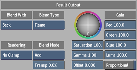

Result Output Settings
Blend With box
Select whether you want to blend the inputs with the second input clip, the background clip or a colour.
Blend Type box
Select the set of blend mode operations available in the Blend Mode box.
Clamping box
Blend Mode box
Select a blend operation. Options determined by Blend Type box.
Transparency field
Gain Trackball
Saturation field
Gamma field
Offset field
Red Gain field
Green Gain field
Blue Gain field
Luma Gain field
Proportional button
