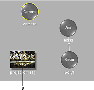

    • Drag the Projector node from the node bin and place it in the schematic.
    • Drag the Projector node from the node bin and place it where you want it in Result view.
    • Double-click the Projector node. You do not need to be in Schematic view to add a node in this manner.
    The Projector node appears in the schematic and a projector icon appears in the scene.
    (a) Projector node
  4. Double-click the Projector node to display the Projector menu, or follow the tab population rules for the Object menu (see Populating Menu Tabs of Selected Objects).
    The Projector is selected.

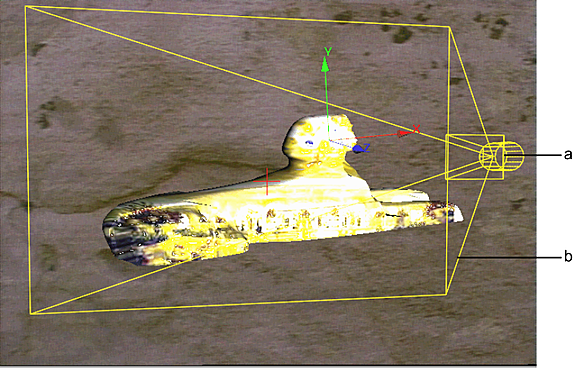

  5. Switch to Camera view to manipulate the projector in the scene using the View option.
    (a) Projector icon (b) Yellow outline shows the projector field of view
