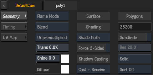

You can change and animate parameters such as the colour, specular highlight, shine, and transparency of 3D models. You set these parameters using the Geometry menu. To access this menu, double-click a Geometry node in the schematic, or follow the tab population rules for the Object menu (see Populating Menu Tabs of Selected Objects).
Blending Settings
Blend Type box
Select whether to use Flame or Photoshop blend modes.
Blend Mode box
Select how the 3D model and the scene are combined. The available list of modes depends on the selection in the Blend Type box.
See Surface Blending Modes.
Transparency field
Displays the transparency level of the 3D model.
Shine field
Displays the intensity value of the specular highlight. When this value is zero, the specular highlight is disabled. Shine affects both size and intensity.
See Creating a Specular Highlight on a Model.
Specular colour pot
Displays the colour of light reflected by the 3D model's surface. To enable the specular highlight, the Shine value must be larger than 0.
Diffuse colour pot
Displays the diffuse colour.
Surface Settings
Shade Order box
Select the drawing priority of the 3D model normals.
Select:To draw the polygons:
Shade BothThat are both facing and opposite the camera.
Shade FrontFacing the camera last.
Shade BackOpposite the camera last. This option is especially useful for semi-transparent models
Force 2-Sided button
Enable to have lights in the scene light both the inside and outside of the geometry (when shading is turned on).
Shadow Casting box
Select how the selected geometry object will be affected by a Shadow Cast object in the scene.
See Surface and Geometry Shadow Casters.
Polygons Settings
Polygons field
Displays the number of polygons in the 3D model. Non-editable.
Subdivide button
Enable to create high-quality shading for polygon models.
Resolution field
Displays the geometry resolution of the 3D model. Active when Subdivide is enabled.
Wireframe box
Select a wireframe option for the 3D model. When you render the 3D model with Wireframe or Original Wire selected, it retains its light, shading, and texture attributes.
Select:To:
SolidDisable wireframe for the 3D model (filled polygons are drawn).
WireframeDisplay the model as a wireframe outline (triangular polygons only).
Original WireDisplay the model as a wireframe outline (original mesh; any polygon type). May be useful for imported geometries.
Sort box
Select how the 3D models contained in the scene are drawn.
Select:To:
Sort OffNot apply any sorting.
Sort AllSort all objects according to the Z-order and the order of the object group (Material ID).
Sort TransparencyGive transparent objects lower priority than opaque parts, to solve transparency issues if the scene contains semi-transparent 3D models.

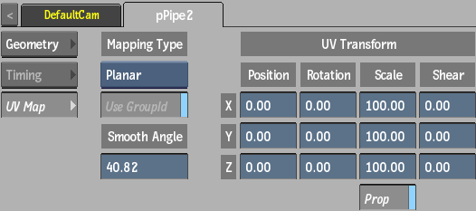

UV Map Settings
Use the UV Mapping settings to select how the UV coordinates of an attached displace, normal, or diffuse node are mapped to the 3D model. You can also apply axis transformations to the UV map. These transformations are different from the settings of the parent axis in that they transform the axes of the actual UV map coordinates.
UV Mapping Type box
Select the type of UV mapping to apply to the attached node.
When a Displace or Normal node is attached to a geometry, you may need a UV mapping type other than Default for the displace or normal pattern to have any effect on the geometry.
Note: When a Diffuse node is attached to a geometry, you must select Wrap from the Mapping box in the Diffuse menu to be able to use the UV mapping settings. See Diffuse Mapping.
Use GroupId button
Enable to respect GroupId information in an FBX file created in 3ds Max.
Smooth Angle button
Enable to override existing normals in the geometry, then use the Smooth Angle field to change the value.
Smooth Angle field
Displays the angle at which the edges of normals become hard. Changes to this field only affect the shading of the displacement, and not the shape.
Position X field
Displays the position of the X axis.
Position Y field
Displays the position of the Y axis.
Position Z field
Displays the position of the Z axis.
Rotation X field
Displays the rotation of the X axis.
Rotation Y field
Displays the rotation of the Y axis.
Rotation Z field
Displays the rotation of the Z axis.
Scale X field
Displays the scale of the X axis.
Scale Y field
Displays the scale of the Y axis.
Scale Z field
Displays the scale of the Z axis.
Prop Scale button
Scales the X, Y, and Z UV axes proportionally.
Shear X field
Displays the shear of the X axis.
Shear Y field
Displays the shear of the Y axis.
Shear Z field
Displays the shear of the Z axis.
Note: The UV Transform fields are only available if a Mapping Type other than Default is selected.
