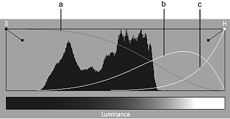

    (a) Shadows curve (b) Midtones curve (c)Highlights curve
    The X-axis is luma and the Y-axis is weight. The Shadow curve is labelled “S”, the Highlight curve is labelled “H”, and the Midtones curve is not labelled.

To see the effect of adjusting these curves:
  1. Adjust the colour balance for each of the Shadows, Midtones, and Highlights channels. Note the effect that this setup has on the image.
  2. Display the Ranges menu. Adjust the curves using the tangent handles.
    You should see that the resulting image is different from that in step 1. The difference is the result of the changes you made to the luma curves for the shadows, midtones, and highlights.
