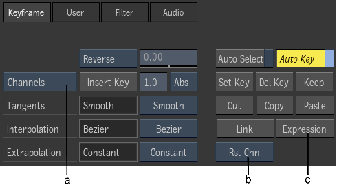

To apply an expression to a channel:
  1. In any module menu, click Animation.
    The Animation controls appear.
    (a)Channel View box (b)Reset Channel button (c)Expressions button

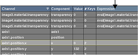

  2. From the Channel View box, select Info.
    Channel information appears in a tabular grid for easier viewing of expressions and channel details. From Info view, you can click the Expressions column heading to sort by expressions and view them more easily.
  3. Select the channel to which you want to apply an expression.
  4. In the Animation controls, click Expression.
    The Expression field appears below the Animation editor.
