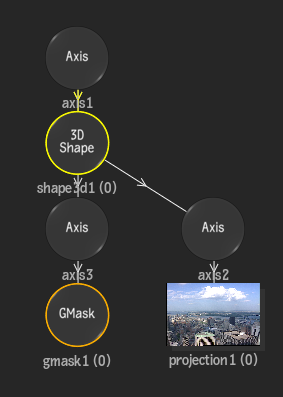

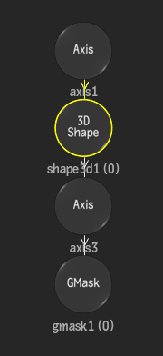

  • When you add a 3D Shape node, in the Action schematic, notice that a hierarchy of a 3D Shape node and GMask node (each with its own Axis) is created. You use the GMask to draw an open or closed spline. The menu structure allows you to see and use the 3D Shape settings on the left and the GMask settings on the right.
  • You can add as many GMask nodes to the 3D Shape node as needed. You can decide if an attached GMask is seen as a hole or filled by the parent 3D Shape. A Spline Combination box in the 3D Shape menu allows you to set the combination pattern if you use multiple GMasks.

  • As with 3D Text geometries, you can attach different textures to the front, back, and extrusion of a 3D Shape using the Multi Material function. With a 3D Shape geometry, you can also apply a media projection with any media in the Action Media list. For example, you can project the same media onto a 3D Shape spline with gradients, then apply selective lighting only to that area.
