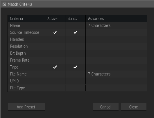

Match Criteria Window
The Match Criteria window enables you to manually select the criteria used to match segments. It has two modes: Active and Strict.
  • Active: Enables the Match Cirteria. When Strict is not selected along with Active, the Advanced column determines the number of characters in the criteria that are required for a Match. You can modify the number of characters used by Name, Tape and File Name when Strict mode is disabled, by changing the corresponding values in the Advanced column.
  • Strict: When enabled, the entire string for that criteria must be present for a Match. In Strict mode, the Advanced column is not taken into account.
Source Timecode, Handles, Resolution, Bit Depth, Frame Rate, UMID, and File Type default to Strict mode when activated.
The Match Criteria window can remain open while tending to other parts of the Conform tab. This allows you to modify the Match Criteria and see the update live in the Conform list. Match Criteria are saved when the Close button is pressed and the Match Criteria that were selected when the dialog window was opened are restored when the Cancel button is pressed.
You can save the selected Match Criteria as a preset, by simply clicking the Add Preset button. You can delete presets using the drop-down arrow, to the right of the button.
Name
The name of the clip referenced by the sequence.
Filename
The filename specified in the sequence as a match criteria.
Source Timecode
The source timecode specified in the sequence as a match criteria. Enables Consolidate on Import.
Tape
The tape name specified in the sequence as a match criteria.
UMID
The starting SMPTE UMID in the sequence as a match criteria. This is only used with MXF files and is ignored in all other cases.
Resolution
The resolution specified in the sequence as a match criteria. If this option is disabled, the Flame applies a Resize FX to the media found to make it match the resolution specified in the imported sequence, if required.
Frame Rate
The frame rate specified in the sequence. Disable to disregard the frame rate; try slipping the clip and using a timewarp in the timeline after loading the timeline to correct any frame rate discrepancy.
Be careful when using the Use Frame Rate search option with FCP XML files, especially if the FCP sequence is using multiple frame rates. With Use Frame Rate enabled, Flame uses the frame rate of the sequence's edits as a match criteria to relink to the correct sources: if the frame rate of the considered source is 24 fps while the edit is at 30 fps, that source is not a potential candidate. Whether or not Flame relinks the considered source to the edit has nothing to do with the frame rate of the sequence.
But, if you are importing an FCP sequence, Flame timewarps the edits so that they match the frame rate of the imported sequence. For example, an FCP sequence @60fps contains edits @50fps: Flame timewarps the edits to 60 fps as it imports the sequence. Whether or not edits are relinked to their sources has nothing to do with this: if Use Frame Rate is enabled, Flame only relinks the above edits if the sources are matching the edits' original frame rate, in this case 50fps.

Name, Frame, Version, Track, Polarity, Width, and Height are displayed in the
