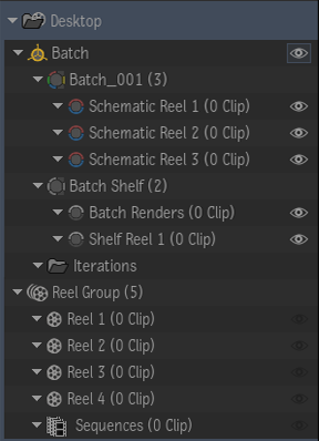

Media to be used in finishing and editing operations on the Desktop is organized into reels for easy access. Individuals reels may be copied, moved, and deleted as well as have their visibility turned on and off. Only a single group of reels can be displayed in Desktop Reels view at any one time.
There are three types of Desktop reels available to help organize media:
  • Schematic reels containing sources used in Batch process trees. Located under a parent Batch group.
    Additional schematic reels may be created if needed by right-clicking the Batch group or reel and selecting New Schematic Reel.
  • Shelf reels, where media can be organized and accessed in Batch without cluttering up schematics and their process trees. The Batch Renders reel is a shelf reel provided as the default destination for all clips rendered via the Render node; however further shelves may be added or deleted as desired.
    Additional shelf reels may be created if needed by right-clicking the reel and selecting New Shelf Reel.
  • Reel Group reels, where media can be organized outside of Batch but still on the Desktop. A Reel Group and the Sequences reel are central to the Connected Conform workflow.
    To automatically include a Reel group on the Desktop in new projects, enable Create Reel Group in the Media Panel tab of the User Preferences.
