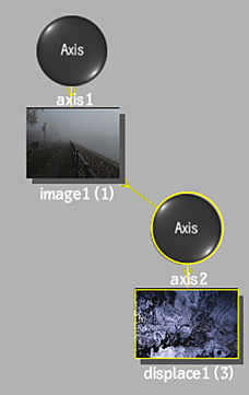

    The displace object is added to the schematic with its own parent axis. The new axis is the child of the selected surface or geometry. In Schematic view, the number in brackets next to the name of the displace node indicates the media used for the displacement.
    To specify different media as the source, select the media in the Media menu, then click Apply, or use the Read File menu to manage the texture media (see Working With Textures in Map Nodes).
