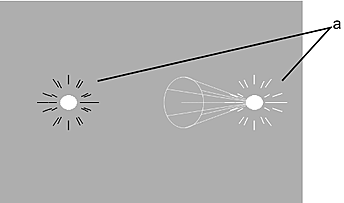

  3. Enable Active in the Light menu to activate the light source.
    The light icon appears in the scene.
    (a) Light sources in the scene.
