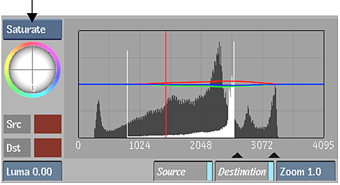

To saturate specific hues of an image:
Click Basics to display the Basics menu.
Select Saturate from the Trackball option box.
Drag the Saturate trackball towards the colour you want to saturate while monitoring the 2D vectorscope. Drag until the colour is closer to the edge of the 2D vectorscope. For example, to saturate reds, move the trackball towards red.
Note: To make the trackballs respond to changes in pressure, use the Pointer preferences in the Preferences menu.Release the trackball.
To further increase the saturation of the same colour, use the trackball to move the colour closer to the edge of the 2D vectorscope.
