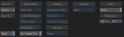

To manually set UV coordinates for a UDIM tiles texture:
  1. Load the untextured FBX attach a Material node to the Geom node.
  2. Attach the required map to the Material node. In the example above, a Diffuse map.
  3. Display the menu for the Diffuse map, and select the Texture menu.
  4. In the UDIM section:
    • Enable Active.
    • Set the number of tiles along the U and the V axis. In the above example, this is U-4, V2.
    The map should texture the Geometry nicely. If not, either you have the wrong texture/coordinates combination, or your geometry has the wrong UV mapping.
Every Texture Map Texture menu has a UDIM section to apply the UDIM scaling, based on the number of tiles contained in the resulting texture. On import, if UDIM is enabled, it is set automatically to Active with the appropriate U and V values. Whether the resulting texture comes from MediaHub or Batch, you can set the U and V values for the grid, allowing the scaling to be properly applied.

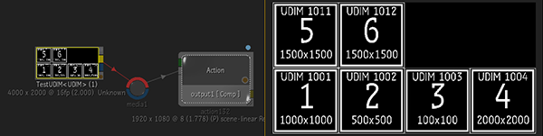

But Action cannot load UDIM tiles in multiple textures. When you load a UDIM, a texture that contains all the tiles is created.
The 6 UDIM tiles got combined into a single Action texture.

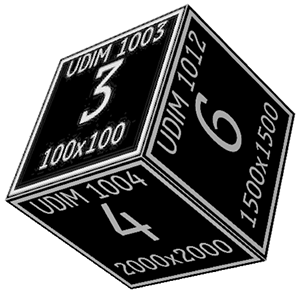

The Action schematic with the FBX cube and the UDIM texture.
This differs from other application because Action cannot stream UDIM tiles to the GPU, must must rather load a single texture to it.
