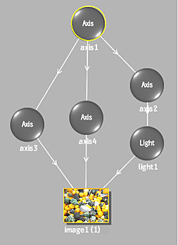

Axis selected
The Axis menu of the selected axis appears on the left side of the Object menu, and a limited number of the children objects' menus appear on the right side of the Object menu. The children objects are identified by scanning the hierarchy of the schematic from top-to-bottom (starting at the selected axis). The hierarchical scanning stops for any given branch when a non-axis object is encountered.
The order of tabs is determined on a per branch basis; that is, all of the tabs of one branch are listed before moving to another branch, starting with the highest levels in the parenting hierarchy (lowest index levels).
For example, in the following schematic, Axis 1 is selected.
The tabs in the Object menu appear as follows. The image1 tab appears in light blue to signify that multiple objects are connected down to it. Use the tabs to switch between menus within the Object menu. The Camera tab appears in orange as the first tab on the right side of the Object menu, and is exempt from the tab population rules.
Note: If there are more than five tabs on either side of the Object menu, use the arrows beside the tab names to navigate to the desired tab.

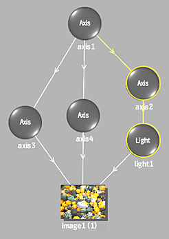

Object with “axis attributes” selected
These types of objects include lights, animators, projectors, and cameras. These objects trigger a different scanning behaviour depending on their position within the schematic hierarchy. If the selected object is the first of its branch (top of the hierarchy), it inherits the tab population rules of an axis, that is, descending branch scanning. If the selected object is not the top object of its branch, it inherits the tab population rules of other objects, that is, ascending branch scanning.
For example, in the following schematic, light 1 is selected.
Since Light 1 is not the top object in its branch, the tabs in the Object menu appear as follows.

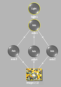

In the following schematic, light 1 is moved to the top of the branch.
Note: The Camera tab appears in orange as the first tab on the right side of the Object menu, and is exempt from the tab population rules. If a camera node is selected in the schematic, the special Camera tab does not appear, and the normal tab population rules apply.
