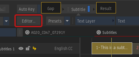

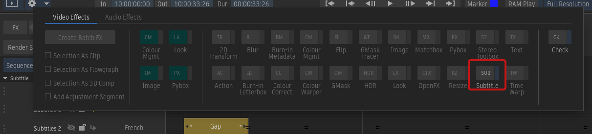

  2. Insert a Subtitle Timeline FX.
  3. Click Editor to open the Effects tab.

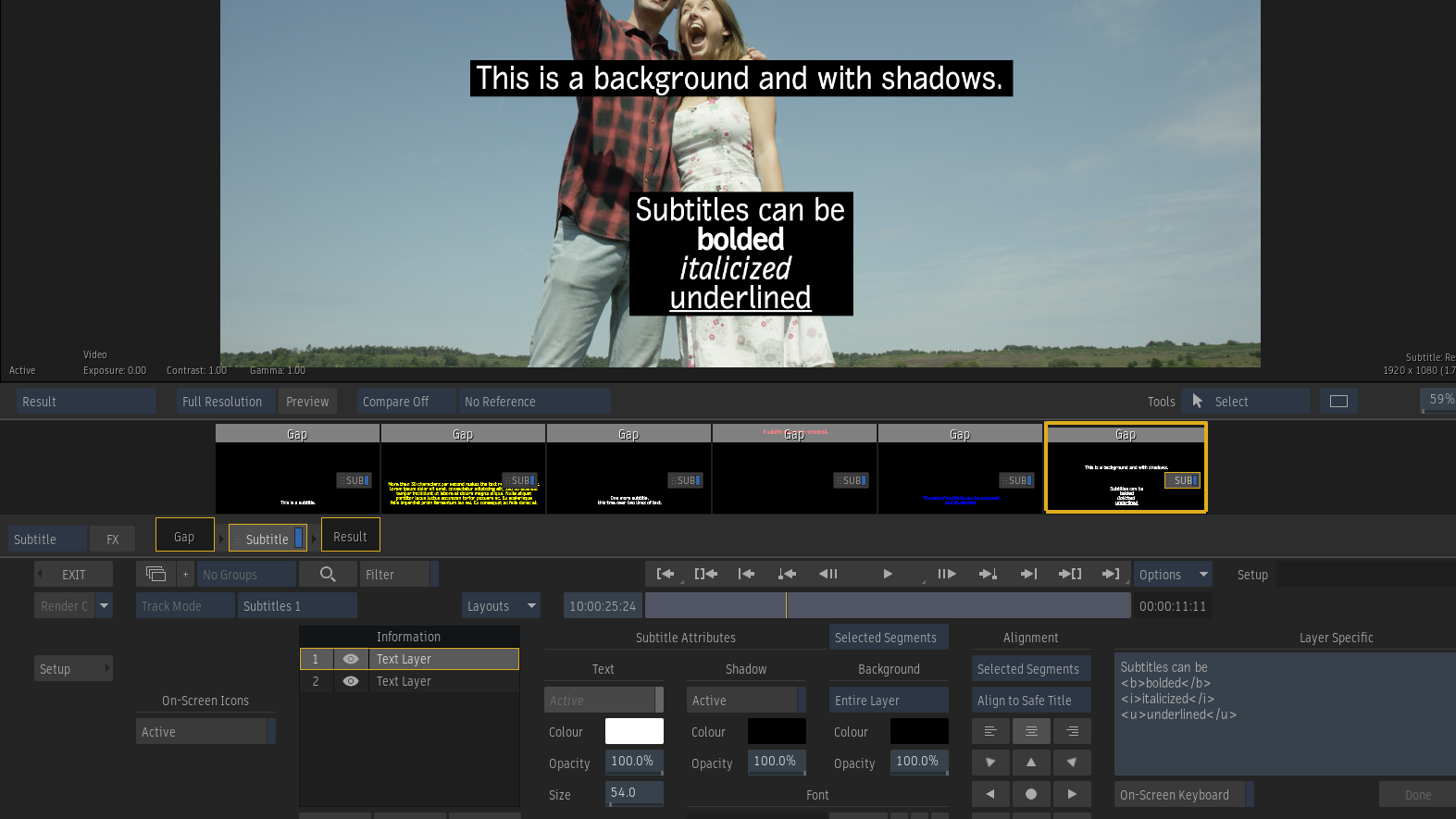

  4. In the Effects tab, use the Subtitles Timeline FX editor to add your subtitles to text layers.
    Enter the subtitle and format the text using the Text, Shadow, Background, and Alignment options.

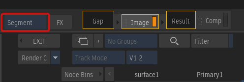

  • In the Effects tab, select Subtitle FX Mode box Subtitle to switch to the Subtitle tracks.

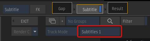

  • Select the Subtitle track to edit from the Track and Version Selection box.
  • Select a segment to display its Subtitle Timeline FX.
    Note: You can also double-click a Subtitle FX in Timeline to open it in Effects.
  • Edit the subtitle in the Subtitles Timeline FX editor.
