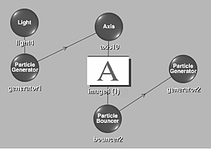

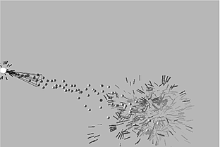

    The following figure shows the schematic and the result of a particle stream that generates a second particle stream. The first particle stream generates spheres and the second particle stream generates quads.

  1. Create a schematic that bounces particles off an image or a bouncer. See Bouncing Particles.
  2. In the schematic, select the Bouncer object.
  3. In the Particle Bouncer menu, select Generator from the Bounce Type drop-down.
  4. Add another particle generator by double-clicking the Particle Generator node in the Node bin.
  5. In the Particle Generator menu, set the particle generator's other properties as appropriate. See Generating Particles.
  6. In the Animation editor, open the second particle generator folder to reveal the properties folder.
  7. Set the Spread and Spread_V channels to control the spread of the second generator.
    If you set the Spread to less than 180, you can also control the rotation of the second particle stream using the Friction field in the Particle Bouncer menu.

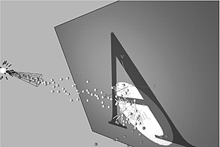

    The following figure shows the schematic and the result of bouncing particles into another particle stream where the first particle stream continues after bouncing off an image surface. The first particle stream generates spheres and the second particle stream generates quads.
