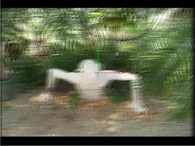

2D Transform
Use 2D Transform to apply basic axis transformations and camera shake effects to clips.
To access the 2D Transform menu, use:
  • Batch, then select a node from the Node bin.
  • Timeline, then use Batch FX. See Creating Batch FX.
  • Timeline, then add Timeline FX from the Effects ribbon. See Adding Timeline FX.
  • Tools, then select from the menu. See Accessing Tools.
  • The Modular Keyer, then select the node from the Node bin.
This node accepts a front and a matte clip, and outputs a result and an outmatte.
