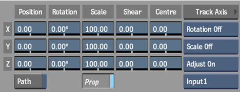

X Position field
Displays the position of the X axis. Editable.
Y Position field
Displays the position of the Y axis. Editable.
Z Position field
Displays the position of the Z axis. Editable.
Motion Path button
Enable to animate the position of the axis using a spline drawn in the scene.
X Rotation field
Displays the rotation value of the X axis. Editable.
Y Rotation field
Displays the rotation value of the Y axis. Editable.
Z Rotation field
Displays the rotation value of the Z axis.
X Scale field
Displays the scale value of the X axis. Editable.
Y Scale field
Displays the scale value of the Y axis. Editable.
Z Scale field
Displays the scale value of the Z axis. Editable.
Prop Scale button
Enable to scale the X, Y, and Z axes proportionally.
X Shear field
Displays the shear value of the X axis. Editable.
Y Shear field
Displays the shear value of the Y axis. Editable.
Z Shear field
Displays the shear value of the Z axis. Editable.
X Centre field
Displays the centre value of the X axis. Editable.
Y Centre field
Displays the centre value of the Y axis. Editable.
Z Centre field
Displays the centre value of the Z axis. Editable.
Track Axis button
Opens the Stabilizer menu to apply tracking data to an axis.
Tracking Rotation box
Select whether tracking rotation is On, Off, or Inverted.
Tracking Scale box
Select whether tracking scaling is On, Off, or Inverted.
Tracking Adjust box
Select whether an offset is applied relative to the spline's axis.
Track Clip box
Select the clip to track.
