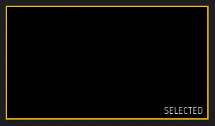

The primary selected clip has a yellow border. Operations that can be applied to only one clip are applied to this clip even when multiple clips are selected. |

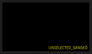

Unselected ganged clips have their information such as the name displayed in yellow. |
