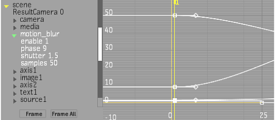

You can animate the Motion blur button, as well as the Phase, Shutter, and Samples fields. They can be found in the Animation editor under the motion_blur folder.
