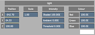

Light Settings
Light X Position field
Displays the horizontal position of the light.
You can also use the light icon in the image window to change the position of the light.
Light Y Position field
Displays vertical position of the light.
Displays the depth of the light.
Tip: You can also use the light icon in the image window to gesturally position the light.
Light Scale field
Displays a value that you can modify to see the results of moving your light when using extreme X, Y or Z values.
Shaded field
Displays the level of intensity for the image.
Ambient field
Displays the percentage of overall lighting for the image.
Threshold field
Displays the percentage of bumps filtered out by using light exposure.
Red Light field
Displays the red value of the light.
Green Light field
Displays the green value of the light.
Blue Light field
Displays the blue value of the light.
Light Colour Pot
Displays the colour of the light. Click to open the Colour Picker and specify a value.
