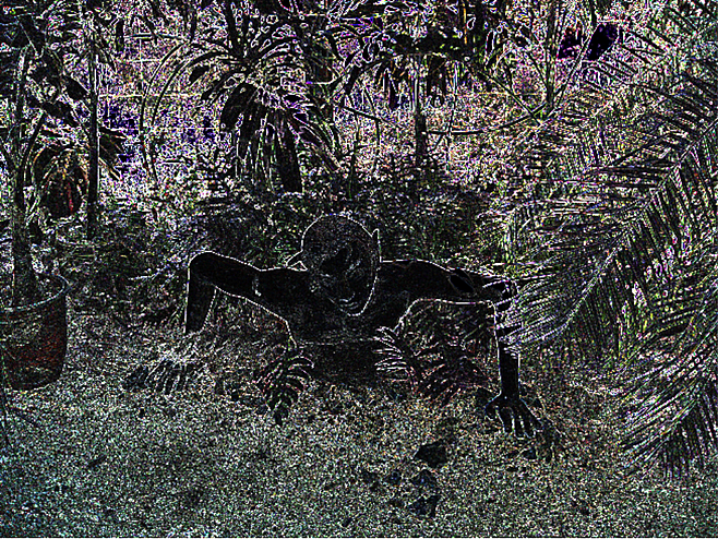

Edge Detect
Use Edge Detect to trace the edges in a clip based on colour. This data can then be used to create a range of artistic effects in various colour spaces.
