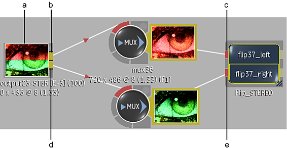

  2. Connect the left and right eye inputs of the stereo group node to the clip node’s left and right eye outputs, as shown in the following example.
    (a) Clip containing stereo track (b) Left eye output tab (c) Left eye input tab (d) Right eye input tab (e) Right eye output tab

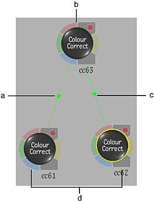

    The schematic is dimmed except for the two nodes of the same type as the one you dragged from the node bin. A green-arrowed dotted line indicates that the nodes are linked as mimics.
    (a) Master node (b) Mimic link (c) Mimicked node

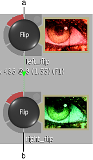

    Notice that the changes made to one node are mimicked on the other node so that both the left and right eye clips are affected simultaneously.
    (a) Flip node connected to left eye is edited (b) Settings are automatically mimicked on Flip node connected to right eye
