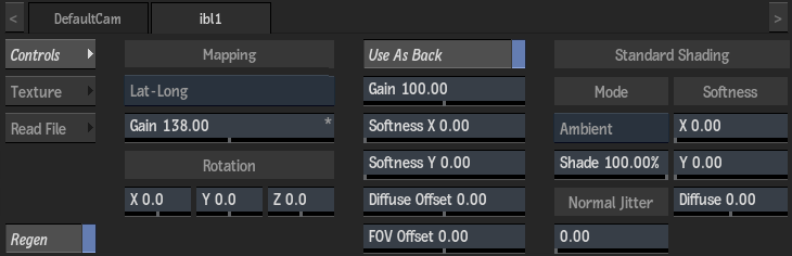

The settings in the IBL menu are as follows.
Mapping Settings
Mapping Type option
Select the type of texture mapping. Use the Map Convert tool to convert different mapping types (for example from spheric to one of the supported types).
IBL Type: Description: Example:
Angular Usually a high-dynamic picture of a mirrored ball.
Cubic A series of images shown as an unfolded cube displaying six sides of the image.
Lat-Long An image mapped onto an unfolded cylinder (also known as cylindrical maps).
Light Probe Images courtesy of Paul Debevec, www.debevec.org
Gain field
Displays the overall brightness of the IBL map.
Regen
Enable to dynamically refresh the image as changes are made to the IBL settings.
Rotation Settings
Rotation X field
Displays the level of rotation of the IBL map along the X axis.
Rotation Y field
Displays the level of rotation of the IBL map along the Y axis.
Rotation Z field
Displays the level of rotation of the IBL map along the Z axis.
Background Settings
Use As Back
Enable to use the selected IBL map as the background in the scene. Background settings appear when enabled.
Background Gain field
Displays the overall brightness of the IBL map when used as a background.
Background Softness X field
Displays the amount of X-axis blur applied to the IBL map when used as a background (not available when Cubic is chosen as the mapping type).
Background Softness Y field
Displays the amount of Y-axis blur applied to the IBL map when used as a background (not available when Cubic is chosen as the mapping type).
Background Diffuse Offset field
Displays the offset based on an attached diffuse map or the existing diffuse light in the image when used as a background.
FOV Offset field
Displays the field of view offset applied to an IBL map that is used as a background. Use to simulate a zoom in or out of the background.
Standard Shading Settings
PBS shading may override these settings, but one IBL map can be used for both PBS and standard shading in the same scene.
IBL Type option
Select whether to apply Ambient or Reflection IBL mapping. Extra settings appear when Ambient is selected.
Shade field
Displays the amount of lighting used.
Jitter field
Displays the sampling area used to calculate the normal information for ambient lighting effects. Available when Ambient is selected as the IBL type.
Softness X field
Displays the amount of X-axis blur applied to the IBL map (not available when Cubic is chosen as the mapping type).
Softness Y field
Displays the amount of Y-axis blur applied to the IBL map (not available when Cubic is chosen as the mapping type).
Displays the offset based on an attached diffuse map or the existing diffuse light in the image.
