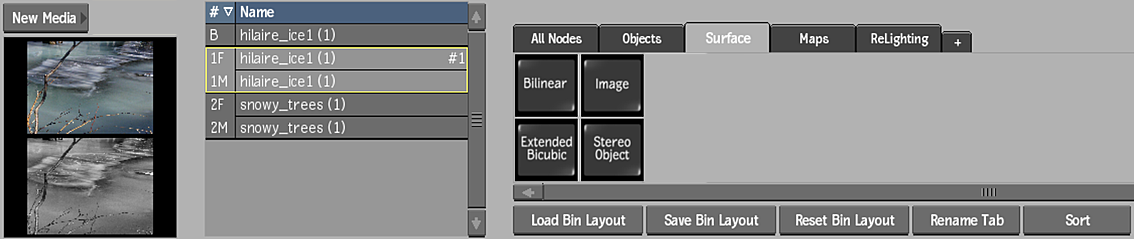

The Action Node Bins menu contains nodes classified in different bins. The All Nodes bin contains all nodes available in Action. The other bins can be customized and custom bins can be created. The Node Bins menu also contains an image proxy that displays a preview of the currently selected media, as well as a Media list.
To access the node bin, click Node bins.

Customizing the Node Bin
Create custom bins and populate them with your most commonly used nodes to optimize your workflow. As well, change the order of the bins along the top of the menu and rename them to reflect their content.
The All Nodes, Lightbox, and Matchbox tabs cannot be customized or deleted.

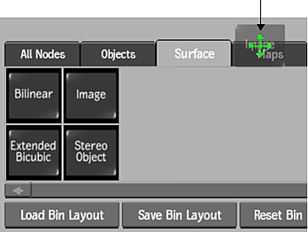

To reorder a bin:
  1. Click and hold a tab, then drag it to the left or right.
  2. As the tab follows the cursor, a blue line will indicate where the bin will be inserted when you release it.
    If you dragged the tab on top of an existing tab, the existing tab shifts to the right and the moved tab is inserted in its place.
