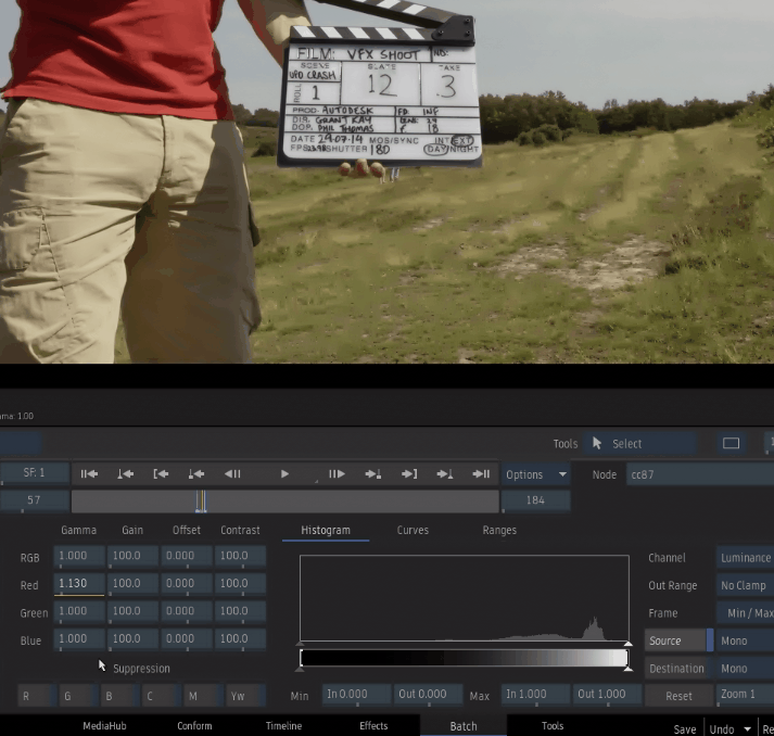

The Animation Animation editor offers more control over your animation than is offered when editing the values of parameters in an effect or node editor. Use the Animation Animation editor to fine-tune changes across all animation channels available for the effect or tool you are working on.
To display the Animation editor:
  1. Click Animation.
    The Animation Animation editor is displayed in the bottom area of the window.
To display the Animation Animation editor in a viewport:
  1. Open the View drop-down and select Curves, Dope Sheet, or Info in the Animation submenu.
To display the curve of a channel in a viewport:
  1. Right-click a field and select Open in the Animation View.
Icon: Option: To Display:
Curves Animation curves.
Dope Sheet Animation channels as tracks. This view helps you visualize and align keyframes.
Info A table displaying keyframe values in text format. It also displays expressions applied to channels.
