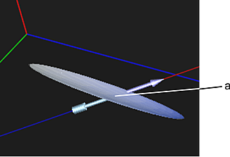

Position the arrow of the selected element in the direction in which you want the ellipsoid or patch to grow or shrink. For example, point the arrow towards colours you want to include in your sample. Alternatively, plot a point to position the arrow. See Controlling Elements with the Directional Arrow.
Press and hold V on the keyboard and click anywhere in the RGB viewer.
A vertex is added to the hull at the intersection of the arrow and the edge of the ellipsoid or patch.
(a) Vertex is added to the hull
Note: When using V in the RGB viewer, you can scale any convex hull (tolerance, softness or patches). If you use V in the image window, it will apply to softness only.To add colours to the sample, drag the cursor to the right. This moves the vertex in the forward direction of the arrow.
