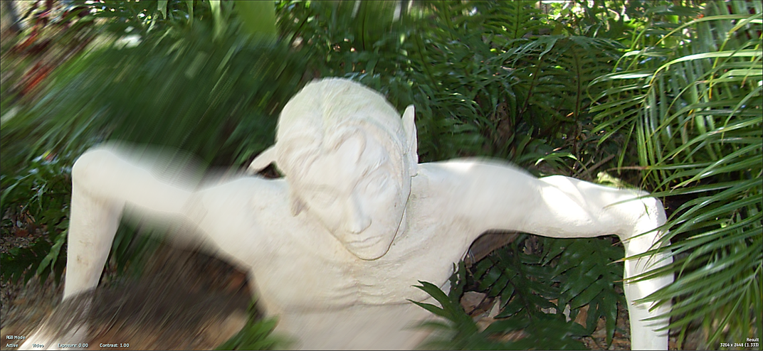

Motion Blur
Use Motion Blur to simulate the blur created by fast moving objects.
