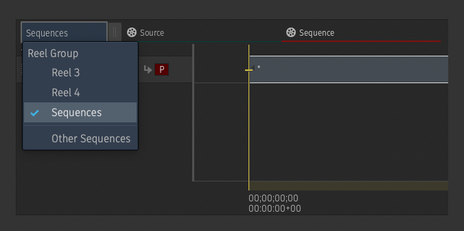

The Timeline view, by default, displays a single Source Timeline tab. This tab shows the content of the source clip selected in the Media Panel. It also shows Sequence tabs for all open sequences in the Selected Reel. To visualise sequences open in a different reel, use the Reel selection drop-down button at the top left of the Timeline view.
