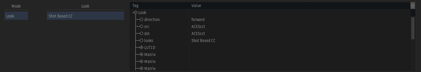

Applying a Look from an OCIO Config
First, set the Mode menu to "Look". Then, from the Look menu, select the Look transform from your OCIO config.
Each Look in an OCIO config specifies a process_space which is the colour space the Look is designed to be applied in. OCIO will convert the incoming colour space to the process space, apply the Look transform, and then convert back to the incoming colour space.
Important: It is essential that your incoming media is tagged with the correct colour space.

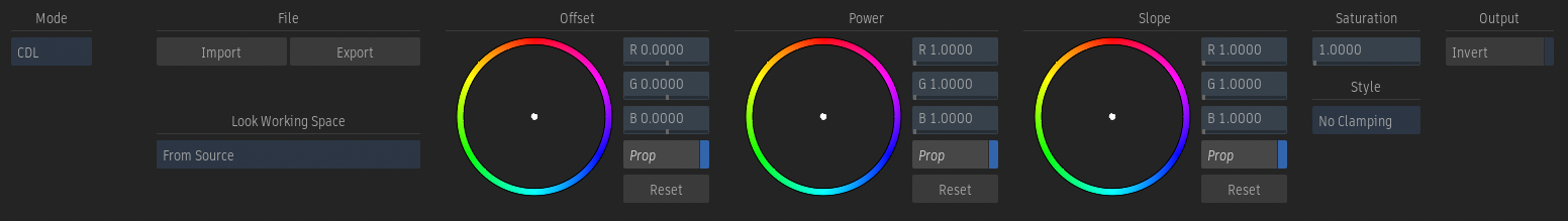

To work with CDLs, first select "CDL" from the Mode menu.
To create a CDL, use the following settings:
  • Offset: Use the colour wheel or the RGB numeric fields.
  • Power: Use the colour wheel or the RGB numeric fields.
  • Slope: Use the colour wheel or the RGB numeric fields.
  • Saturation: Use the numeric field.
  • Style: Controls the math used when applying the CDL. ASC v1.2 uses the math from the American Society of Cinematographers' Color Decision List specification (version 1.2), which requires clamping values outside [0,1]. Therefore there is a second option, No Clamping, that applies the same math but without clamping values. The exact math for each option are described here.
    The default value for the Style setting may be configured in the Preferences Colour Management, with the Default CDL Style button.
  • Invert: Use to invert the processing of a Look node.
    Note: The status of the Invert button is ignored when you export the settings of the Look tool.

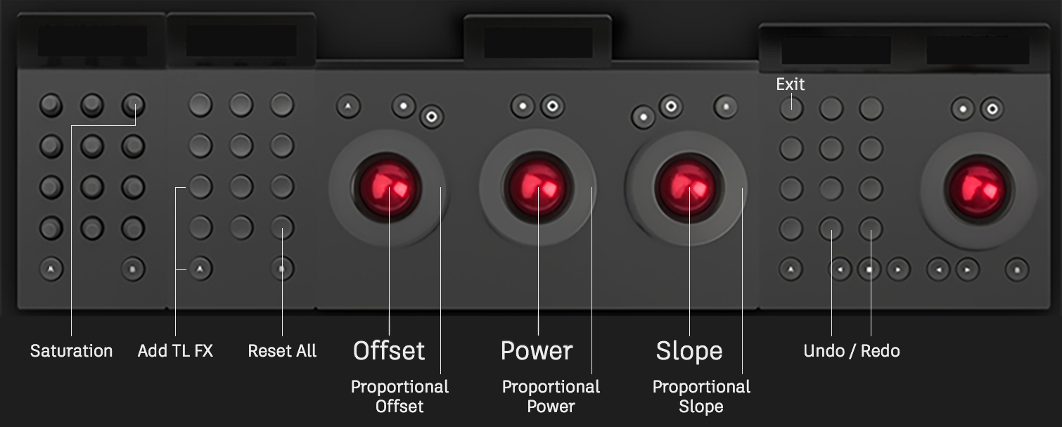

Tangent Panel Support
You can use the Tangent Element panel to modify the Look node settings, including the settings in the Timeline FX Ribbon.
With the Tangent Element panel, you can:
  • Add a Look Timeline FX from the Action's second page.
  • Exit the Look Timeline FX editor.
  • Modify the Offset with the left trackball. Use the outer ring to proportionally modify it.
  • Modify the Power with the middle trackball. Use the outer ring to proportionally modify it.
  • Modify the Slope with the right trackball Use the outer ring to proportionally modify it.
  • Modify the Saturation with the top right knob on the knob panel.
  • Reset using the standard buttons on the panel.
  • Undo or Redo using the standard buttons on the panel.
