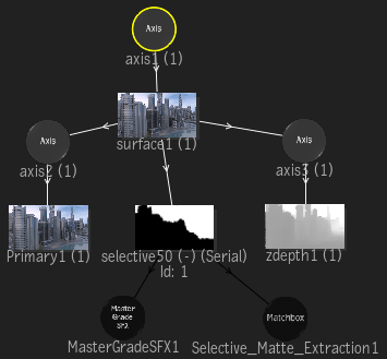

To extract a matte from a Selective:
Create a Surface object.
Right-click the Surface and select Add Selective.
Right-click the Selective node and select Add Selective FX, then select the SelectiveMatteExtraction matchbox.
SelectiveMatteExtraction used to extract a matte created from ZDepth data
In Action Output menu, create a new Output Render Layer and assign it the Surface object created in step 1 (Right-click
View/Render
Add to Output) .This ensures it outputs the Selective result as a Matte in the Comp (Primary) output. See About Rendering Outputs from Action for information on render layer outputs.
