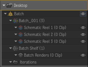

Desktop
Organizes the Workspace into two distinct working areas: Batch groups (or Batch FX groups for Flame Assist) and Reel groups.
Batch Group
The top level of the Batch compositing interface. The icon for the currently-active Batch group is highlighted in yellow. A project may contain multiple Batch groups, which can each be copied, duplicated, colour-coded, and renamed among other actions. Unless otherwise set in the Media Panel tab of the User Preferences, each new Batch group contains: the current Batch iteration containing the schematic reels where process trees are assembled; the Batch Shelf containing the Batch Renders reel and Batch Shelf reel; and the Iterations folder (if shown) where incremented saves of the parent Batch group are stored.
Batch Iteration
The second level of the Batch structure, containing the schematic reels. The name of the current iteration is displayed and the number of reels is shown in parenthesis. Schematic reels may be added or deleted, and renamed or colour-coded.
Batch Shelf
Organizes media on reels outside of Batch iterations. Includes the Batch Renders reel and the Shelf reel. The number of reels is shown in parenthesis. Shelf reels may be added or deleted, and renamed or colour-coded.
Iterations
Stores Batch iterations. This folder may be shown or hidden depending on the Workspace preferences. For more information, see Saving Work using Batch or Batch FX Iterations.
