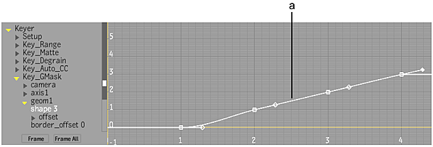

    The Shape channel appears in the Animation editor and any Vertex channel keyframes are converted.
    (a) Shape channel with 4 keyframes
