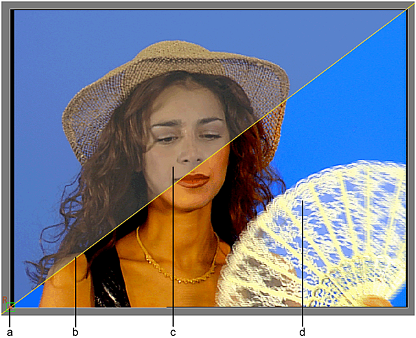

Using the Split Bar
You display the split bar by selecting the Angle Split option from the Compare Modes box.
The split bar has a pivot point (indicated by a small box) around which the split bar can be rotated, or from which the split bar can be moved. The letter R next to the pivot box indicates the side of the bar where the reference clip is displayed.
(a) Pivot point (b) Split bar (c) Current display (d) Reference display
Rotate and move the split bar using these techniques:
  • To rotate the split bar around its pivot point, drag the split bar.
  • To move the split bar, drag the pivot point. You can also Ctrl+Alt-click the image to place the pivot point under the cursor, and then drag over the image to move the split bar.
  • To restore the split bar to its default position, Ctrl-click the pivot point.
