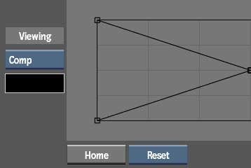

To use a solid colour background:
Double-click the Result node.
The Matte Luminance Curves menu appears.
In the Result box, select Comp.
A colour pot appears.
Click the colour pot under the Comp view output option.
The colour picker appears.
Select a colour for the background using the colour picker.
Your key is displayed on a solid colour background in the Result view.
