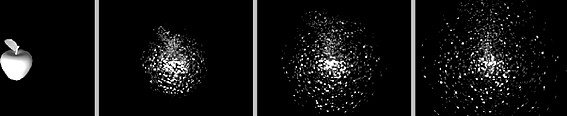

In Action, the main components for generating particles are generators, manipulators, and bouncers. You can also use the particle system to explode a 3D object or an image.

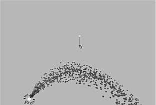

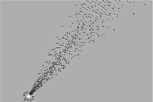

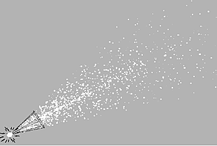

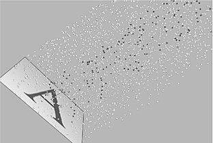

To create a particle stream, start by adding a particle generator that creates a stream of particles when attached to a light source, 3D object, or surface. You can use three different generators: light source, surface, and 3D object.
Particle generators have two settings:

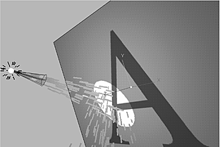

Particle bouncers are used to influence the behaviour of particles when they come into contact with a surface. You can parent an axis or light source to a particle bouncer. See Bouncing Particles.
