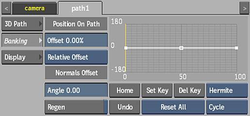

When Align to Path or Look At is selected in the Alignment option option, the Banking menu becomes available. Banking uses the normals of the path to orient objects attached to it. Use the banking curve and settings to control the torsion effect of the object as it travels along the 3D path.
The Position on Path settings are the same as those in the 3D Path menu. See Positioning Objects on the Path.
Banking Curve
Adds twists and torsion to the normals of the 3D path. Use the options in the Tools drop-down to add, select, delete, or move keyframes on the Banking curve.
The horizontal axis represents the length of the path, and the vertical axis displays the orientation, expressed in degrees.
Normals Offset Angle field
Displays the angle of rotation of all normals, applied to the entire banking curve.
Note: Changes made to the banking curve and Angle field are cumulative.
Regen
Enable to dynamically refresh the image as changes are made to the banking curve.
Home
Resets the Banking curve viewer to show the whole curve.
Undo
Undoes Banking curve operations.
Set Key
Sets the current values for the banking curve in the current frame (when Auto Key is disabled).
Del Key
Deletes the selected banking curve keyframes.
Reset Selection option
Select whether to reset all of the banking settings (Reset All) or just the banking curve (Reset Key).
Interpolation option
Select the default interpolation type for the Banking curve.
Extrapolation option
Select the default extrapolation type for the Banking curve.
