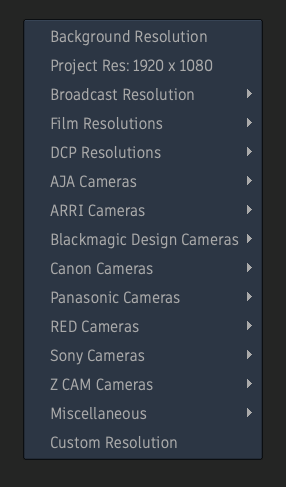

About the Resolution drop-down
Use the Resolution drop-down menu to select a preset resolution.
  • Background Resolution Only available within Action or with an Action node selected. Sets the resolution to the background resolution of Action.
  • Project Res Sets the resolution to the resolution of the project. You set the resolution of the project when you create it. You can change your project resolution in Flame menu Project Settings.
  • Resolutions for Broadcast, Film, DCP, and popular cameras manufacturers.
  • Custom Resolution Use this option to enter a customized resolution.
