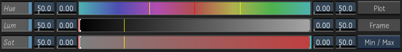

Colour Control Settings
Hue button
Enable to extract hue values for the key.
Minimum Softness field
Displays the minimum hue value of the softness range.
Minimum Tolerance field
Displays the minimum hue value of the tolerance range.
Maximum Tolerance field
Displays the maximum hue value of the tolerance range.
Maximum Softness field
Displays the maximum hue value of the softness range.
Luminance button
Enable to extract luminance values for the key.
Displays the minimum luminance value of the softness range.
Displays the minimum luminance value of the tolerance range.
Displays the maximum luminance value of the tolerance range.
Displays the maximum luminance value of the softness range.
Saturation button
Enable to extract saturation values for the key.
Displays the minimum saturation value of the softness range.
Displays the minimum saturation value of the tolerance range.
Displays the maximum saturation value of the tolerance range.
Displays the maximum saturation value of the softness range.
Plot button
Activates the pick cursor. Use to sample an area of the image to display its colour value.
