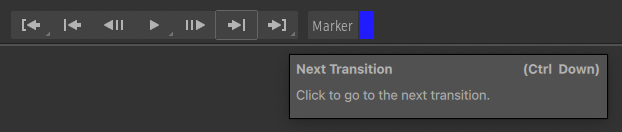

If auto display of tooltips is enabled in the Preferences, hover over the button for which you want to determine the assigned keyboard shortcut. If you have disabled the auto display of tooltips, press and hold Ctrl+Alt+W and hover over the button.
If a keyboard shortcut exists for the button, it is displayed in the tooltip.

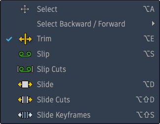

In instances where items in a drop-down list each have their own keyboard shortcuts, these shortcuts are displayed alongside their respective list items.
