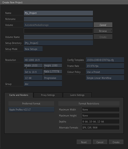

To create a new Storage Volume:
  1. Create a new project by doing on of the following.
    • On the Startup screen, click Project New.
    • In the application, open Flame menu Project and User Settings Project New.
  2. In the Volume section, click Add.
  3. Click Browse.
  4. Select the location of the storage volume, and click Set Path.
    Note: Do not select the root of a drive as the media storage folder. Always create a folder to hold all media files in one place.
  5. Name your volume using Volume Name.
    Volume Name is the name that appears in the Volume menu whenever you create a new project.
  6. Click Create.
    You can now finish setting up the parameters of your new project. Click Create when you are done.
