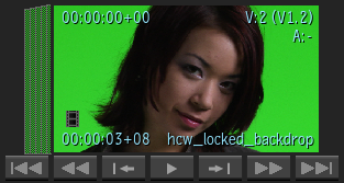

In collapsed view, clips or sequences are displayed as a stack of frames.

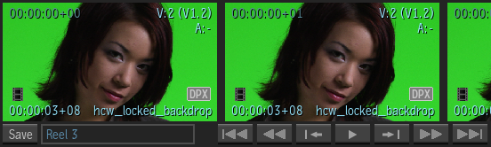

In frames view, clips or sequences are displayed as a strip of contiguous frames.

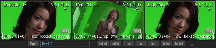

In storyboard view, each segment within your sequence is represented as a frame. Any transitions or cuts between segments are represented as dotted green lines and full yellow lines respectively.
