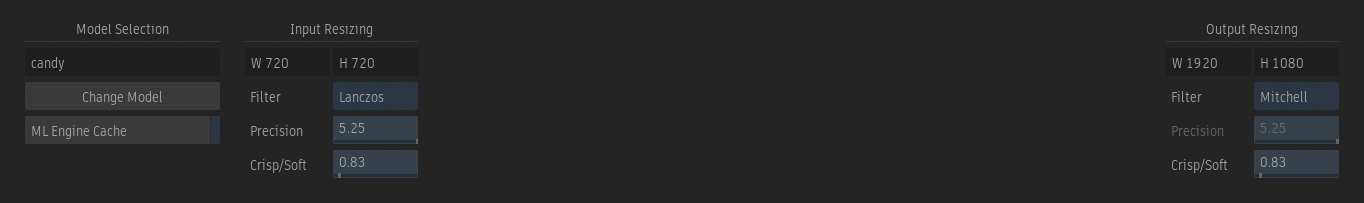

Settings
The Inference node doesn't offer any controls over the models themselves. The only controls offered are the possibility to cache the model (Linux only) and which filters to use on input and output if clips must be resized to the image size required by the model.

Resizing
When a model requires an image of a fixed resolution, an automatic resize takes place before and after the inference. The fixed width and height values are displayed in the Input Resizing section and resizing filter parameters are available to customize the operations for both the input and output resizing.
Note: The Input Resizing and Output Resizing sections are disabled for models that do not have fixed size rendering.
The KeepAspectRatio token of the JSON sidecar file can be used to preserve the input clip's aspect ratio through the resizing process if the model is sensitive to aspect ratio. The default value of the token is true, as most ML models are sensitive to aspect ratio.
Note: The default status of KeepAspectRatio is false in the 2026 version, but true as of the 2026.1 Update
