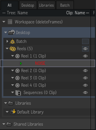

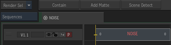

LOST frame on desktop
ICE also flags segments and clips with missing frames. In Flame, segments with missing frames have their name written in red. Clips with segments that are missing frames also have their name coloured red.
Clip with LOST frame Segment with LOST frame
clip with name in red segment name in red
Important: ICE cannot recover missing media, but helps tracking down missing frames in your project. Once you know what frames are missing, relink to the source media, or re-render lost renders.
