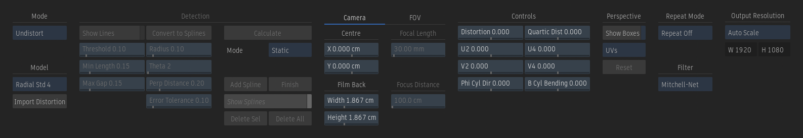

Settings
Mode
Mode option
Select whether to undistort or distort the Front clip.
Select: To:
Undistort Remove the lens distortion so all lines are straight.
Distort Apply back the original lens distortion to your composition.
Tip: Change the mode of a duplicated node to reapply the modifications made on the original node.
Model
Select the model for the distortion calculation from the following options:

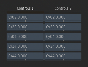

Controls
Controls are used to undistort or distort the image and differ based on the selected model. The two main controls are:
Distortion / c[xy]02 The primary coefficient used to correct barrel or pincushion distortion in an image. This type of distortion becomes more pronounced as points move further away from the centre of the image.
Quartic Distortion / c[xy]22 This is the secondary distortion coefficient. The impact of this coefficient increases with the distance from the centre of the image, even more so than the primary coefficient. If the image exhibits mustache distortion, this coefficient will have the opposite sign to the primary coefficient.
Additional controls are available based on the selected model. When there are more controls than what can be displayed under the Controls section, the header turns into tabs and additional controls can be accessed using them.

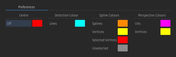

Node Preferences
The appearance of the Centre, Detection Lines, Perspective, and Spline manipulators can be modified from the Node Prefs menu.
