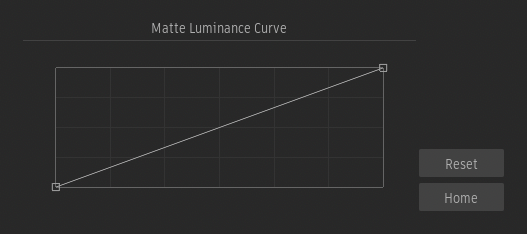

Matte Luminance Curve
Control the blending of the edges. You can add keyframes to the curve using Add Points mode, move keyframes with Select mode, and modify the curve's shape using tangent handles.
Reset
Reset the curve to its default values.
Home
Reset the position and zoom of the curves canvas.
