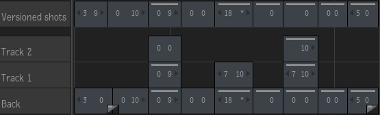

To create a shot:

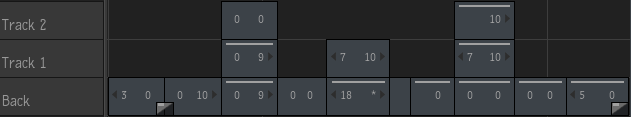

  1. Verify that the shot has a "layered cake" structure.
    This structure is the best layout when publishing a shot: Flame uses a bottom-most left-most segment part of the shot to create the shot's timing structure.
  2. Identify segments that are part of the shot by assigning them an identical shot name. For Flame, a shot is a group of segments that have the same Shot Name.
    You can edit the shot name from the Conform view, or with the Rename Shot option from either the Timeline gear menu or context menu.
  3. Repeat for each shot on your timeline. Make sure to assign each shot a unique name.
    Tip: The Conform tab provides your with a great overview of your timeline, including assigned shot names.
Possible strategy for naming shots:
  1. Select the bottom video track.
  2. Select Rename Shot from the Timeline gear menu.
  3. From the Add Token, select Segment Index. This assigns a unique shot name to each segment.
  4. Now go from segment to segment, assigning each segment the segment id of the bottom-most segment. You can do this in Conform, to edit Shot names in bulk.
When you are ready to distribute the shots, publish them.
To publish the shots to be used by other applications:
  1. Export the sequence.
  2. In the Media Export window, navigate to the root folder.
    The root folder is the published material destination where the published shot structure is created. When you publish shots, you do not only export the media, you also export additional files that provide information crucial to the shot publish workflow, such as Open Clip XML files and Batch setups for each shot.
  3. Set Export to Sequence Publish.
  4. Set Format Preset to one of the Shot Publish existing presets.
    For this procedure, we will use Shot Publish - Flame Root Directory (16-bit OpenEXR and No Audio).
  5. Click Export.
    Once the export is completed, you can see, next your original sequence, the published timeline named as your sequence but appended with _publish.
When you open a shot published sequence, the versioned shot appears on a different Version layer of the sequence. The bottom Version contains the original sequence.
The versioned shot actually contains all of the media of the shot and effects, keeping the timing from the original sequence.
Create New Version
  • Provides access to the open setup in a fashion similar to History. Like History, exiting automatically triggers a new render, however in this case it will create all of the required media and metadata in the appropriate paths in the job tree, and append a version to the timeline segment.
Open as Batch Group
  • Load the currently selected version in Batch. This will include the Write File node needed to append versions to the shot, the job tree, and the segments in the timelines where it is used.
Promote to Batch FX
  • Ingests the shot directly in the current timeline. This removes the connection to the job tree, as well as its versions.
Opening the Shot in Flare
  1. In Flare's Batch view, click Load.
  2. Navigate to the folder where the shot's Batch setups are stored.
    Batch setups for shots are placed in the path defined by Clip Options tab Setup Pattern field in the Media Export window. In the Format Preset Shot Publish - Flame Root Directory (16-bit OpenEXR and No Audio), Batch setups are located in flame/batch/.
  3. Double-click the Batch setup to open it.
  4. Edit the setup.
  5. When done, click Render.
    New media and version information are written to the paths set in the Write File node. The Open Clip XML is updated to include this new version information. And a new version of the Batch setup is automatically saved in the appropriate paths in the job tree.
Viewing a version in Flame:
  1. Right-click the published sequence and select Source Versions Update Source. _publish identifies a published sequence.
    This reloads the associated Open Clip, making sure the latest versions are available for viewing. An updated segment is highlighted in white to indicate that is contains new versions.
  2. Open the published sequence.
    The original sequence is displayed on the bottom Version of the timeline. A new Version contains the track with the published shots and referenced media.
  3. On the Timeline, locate the shot segment on one of the Published shots tracks.
  4. On the Timeline FX ribbon, select a version from the Clip Versions box. Click Pre-Processing if at first you don't see it.
    You can now playback the new version, open it in Batch, promote it to BFX, output it, or simply revert back to a previous version.
