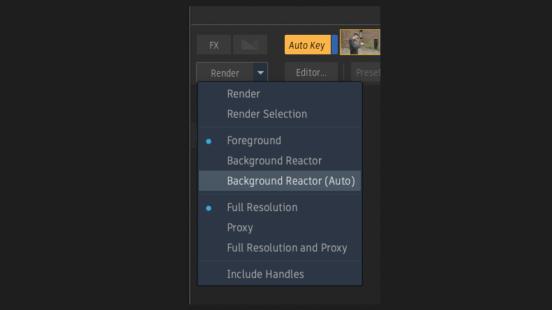

  • The Render button is available from the Transition editors.

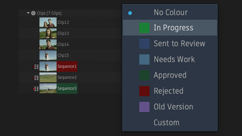

  • Colour coding can be applied to nodes in the Batch, Batch FX, and Modular Keyer Schematic views.
    • A colour can be set using the Colour options from a node's context menu.
    • The colour coding is applied in the form of a colour patch behind a node's name.
    • The list of colour is different for clips and nodes. The former uses the colour set for the Media Panel and Timeline segments; the latter uses a list of colours set in the Colour Coding Preferences.
    • Colour has been added to the Search and Select in Schematic criteria.

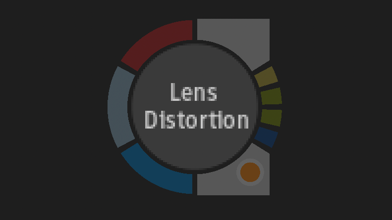

Lens Distortion
  • Improvements have been made to the distortion calculation.
    • The distortion Centre X and Y values are now calculated for all models.
    • The Focal Length value is calculated for the 3D4 Radial - Fisheye - Radial 8 model.
    • Values for the settings in the Controls section are no longer clipped after a calculation or an import file.
  • Use one of three modes to dictate how the distortion calculation is performed.
    • Static: This mode calculates the distortion using the splines at the current frame only.
    • Dynamic: This mode calculates the distortion using every frame where a spline has a keyframe. The result is animated controls with linear interpolation.
    • Average: This mode calculates the distortion using every frame where a spline has a keyframe. The result is non-animated controls with an average value.

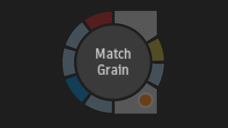

Match Grain
A Setup Range / Custom Range option has been added to the Analysis section. Setup Range is the default value.
  • The Custom Range option offers the same From, To, and Step values as the 2025 version.
  • The Setup Range option sets the From and To fields to the Batch Group's Start and End Frame values. The Step numeric field is initially set to a value that equals the setup duration divided by 20, but is editable.

  • The colour coding applied to a timeline segment is still visible behind the name of a selected segment.
