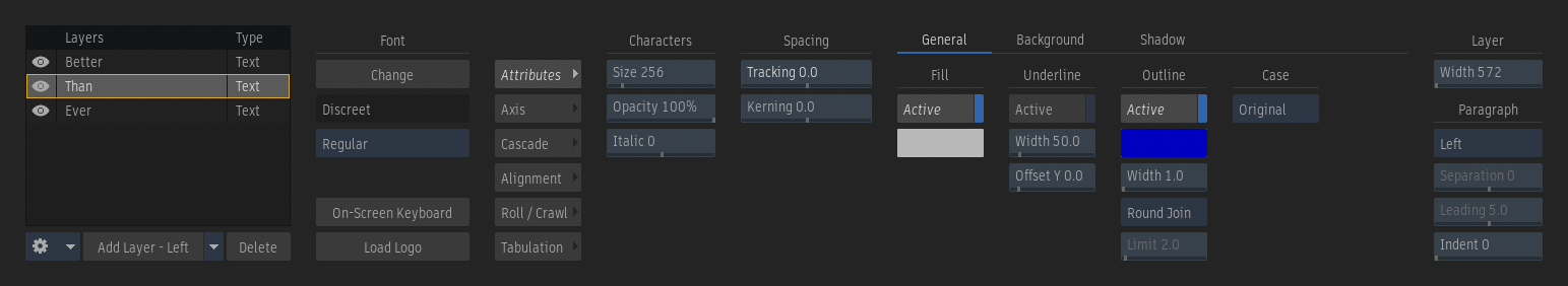

Type (What's New in 2026)
Indicates a feature suggested and voted up by users on the Flame Feedback portal.
Use the Type tool to add text, titles, rolls, and crawls to a clip or sequence. Type replaces Text, now considered a legacy tool.
Highlights include:
Better integration in Batch, Batch FX, and in the Timeline, including support for:
- Multiview.
- Colour management.
- Context views.
Revamped user interface and workflows.
Layers management using the Layers List.
A revamped font workflow, including:
- A redesigned Select Font widget.
- Project-based fonts, allowing modification of multiple instances of Type at once.
- Support for font styles.
- Support for font case selection.
- Support for Adobe fonts.
- Better handling of missing fonts.
Improved kerning workflow.
Improved underline, outline, background, and shadow attributes.
Cascading options like in 3D Text.
Support for Styles in the Explorer and Presets on disk.
Scoping options like Subtitle in the Timeline.
Controls for the Type Timeline FX accessible from the Timeline FX Ribbon.
Improved rendering quality.
See Type for more details.
