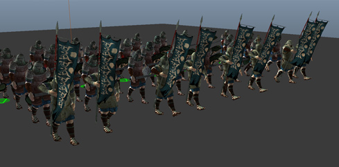

An Apex Cloth Behavior (beApexCLoth) lets you simulate any Nvidia Apex cloth asset that was configured on the Character File. The Apex Cloth Asset can be generated with the Nvidia Maya DCC plug-in for physX 3.4 which is available on the Golaem download website

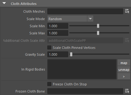

Cloth Attributes
Cloth Meshes
List of meshes asset to simulate with apex cloth. Several mesh asset can be specified by separating them with a comma (,). All the mesh assets must be listed as Meshes in the Geometry Tab of the relative Character File, and should have a Cloth Asset File correctly configured.
The button on the right end is a helper with a list of all mesh assets present in currently loaded entity type. Use it to easier the configuration.
Scale
This attribute allows a choice of three modes :
  • Random: Randomly set the scale value between the specified "Scale Min" and "Scale Max" bounds (this attribute is influenced by the random seed of the Crowd Manager)
  • Per-Particle Attribute: Use the "Additional Cloth Scale Attr" attribute to get the name of the float per-particle field of the relative particle system.
  • Golaem Attribute: allows setting the Scale value from the Golaem attribute set in "Additional Cloth Scale Attr".
Scale Cloth Pinned Vertices Set to true if the skinned mesh on which the cloth is pinned is scaled accordingly
Gravity Scale Gravity scale to use for the apex file

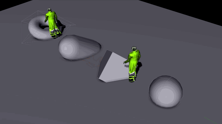

In Rigid Bodies
List of Crowd Rigid Bodies to use as colliders for the cloth.
Limits:
  • box primitives have to be considered as a 6 faces convex hull
  • a maximum of 32 faces per convex hull can be used
You can use the Vertex Limit configuration in the Crowd Rigid Body to try to lower the number of faces of the convex hulls.
Freeze Cloth On Stop If checked, the cloth will keep the shape it has when the stop trigger is set true. To go back to the skinned version of the cloth, it will be needed to start again a cloth behavior and stop it without this option checked.
Frozen Cloth Bone When the Freeze Cloth On Stop option is checked, this lets you freeze the cloth relative to the given bone rather than in world space

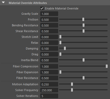

Material Override Attribute
The following parameters override the value stored within the loaded .apx file
The Physical Material parameters are the same as these from the official Nvidia Apex Clothing node. Please check the Physx plug-in documentation for more details
